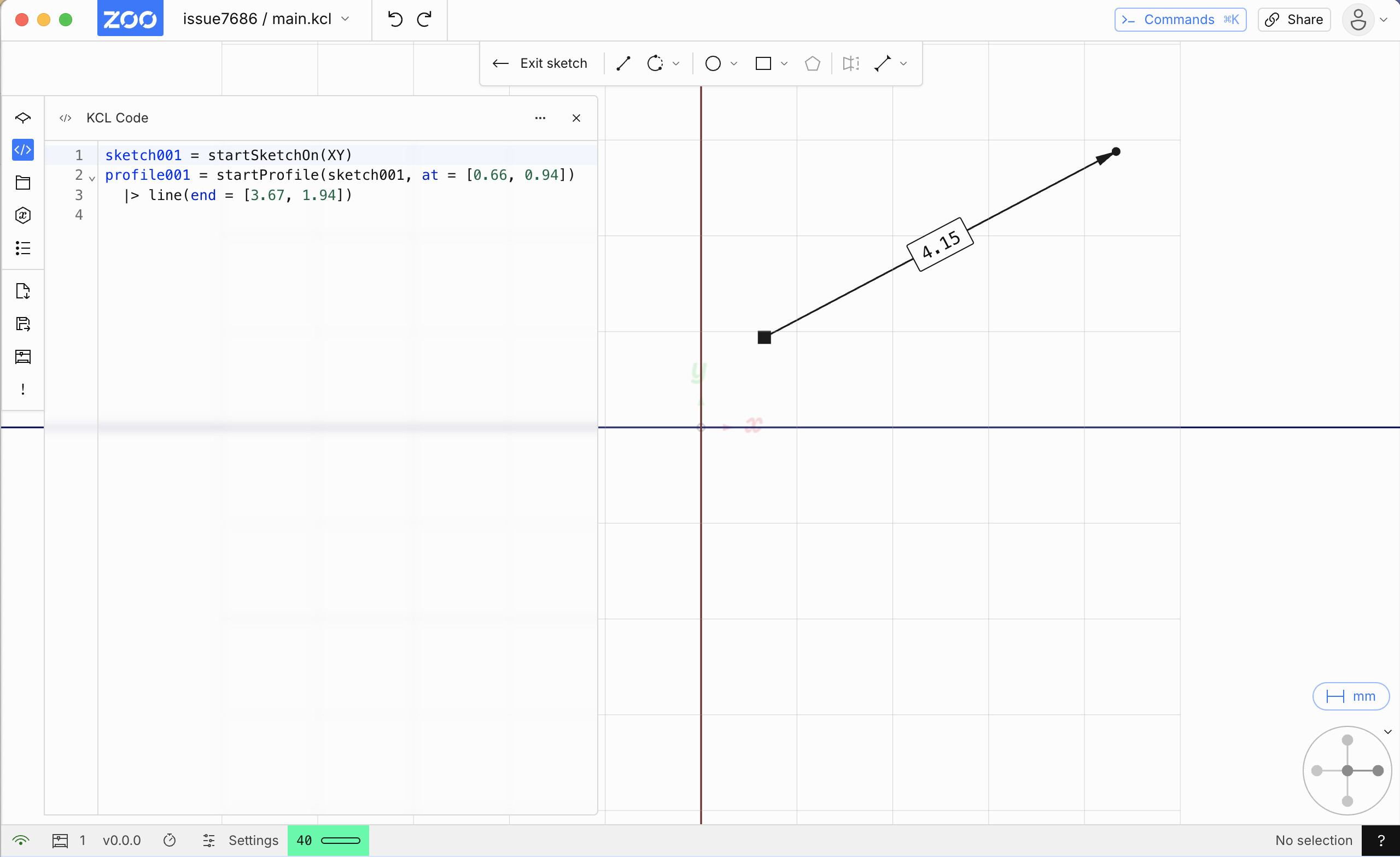

Some more detail about the sketching issue – it didn’t seem to happen with every shape. A 3 point curve worked fine. It did happen every time with a rectangle however, making the tool essentially unusable.
Thank you for calling this out @evelant. I think I’ve found a simple reproduction of the Rectangle issue you’re encountering:
  1. Equip the rectangle tool
  2. type x = 3 or something in the code editor
  3. quickly place the first point of the rectangle
  4. watch the second point be canceled, an a startProfileAt placed
So we’ve got something to go on!

  • I’ve created this issue to track fixing the rectangle bug
  • I believe the black screen issue is a reappearance of this bug
  • I’ll keep looking around for reproductions of the other behaviors you mentioned
Thanks for reporting, we’ll get to work on these bugs under our “V1 Sketch mode improvements” milestone. Keep an eye out for our Sketch mode revamp happening in parallel to implement constraint solver sketching.

@evelant This is a very long shot, but this error appears to be related to a failing lookup in the Feature Tree pane, no clarity yet whether or not this could be related to the issue or not. Are you able to reproduce this when the Feature Tree pane is closed? You can do that by clicking in the sidebar. For instance keeping only the KCL editor pane open like in the screenshot below.
Thanks a lot for your help on this!
Not a very long shot, that did it! If I close the feature tree pane the bug no longer happens.
@evelant Wow that’s great to hear. Thank you so much for testing that quick! We’ll get that sorted soon.
@evelant If it’s not too much to ask, are you able to see this issue on the web app at https://app.zoo.dev? If yes, that would be great as we could push fix attempts there quicker than having to go through desktop releases
Does not happen in the web version. I have the feature tree open and can sketch a rectangle without issue. There are some errors in the dev console, but everything appears to work
