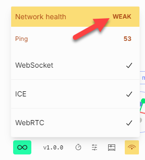

Yesterday, the Network Health toggled back and forth between Weak and Good, but today it’s stuck on Weak.
What exactly is it testing so that I can research this myself?

I was looking into this and figured a few things out.
It appears that a ping time >= 50msec triggers the “Weak” condition, which seems fair enough, but Wireshark doesn’t see any icmp or icmp6 activity from the app, so “Ping” is apparently used in a colloquial sense rather than the specific protocol sense.
Further digging found, to my delight, that you’re using IPv6, and you’re apparently doing an application-level keepalive/ping.
For my purposes this resolves the mystery and this can be closed.
